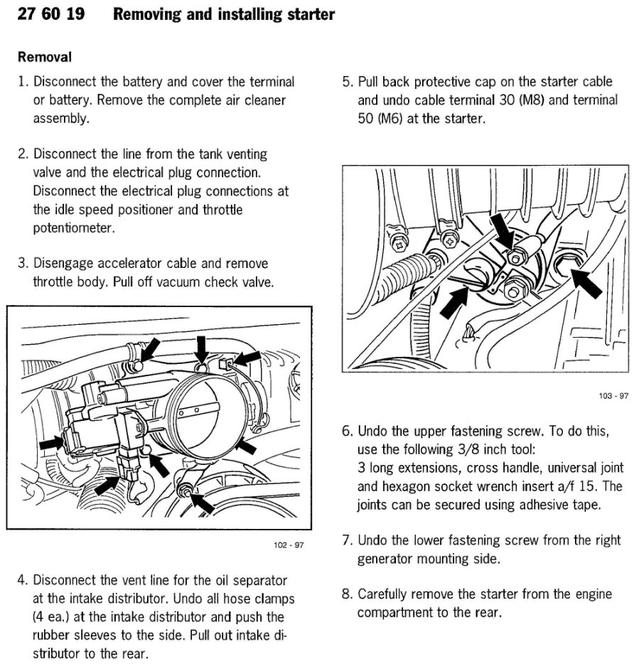

Finally - On a different subject, ...starter motor, does anybody have a picture of where it is located on the engine.

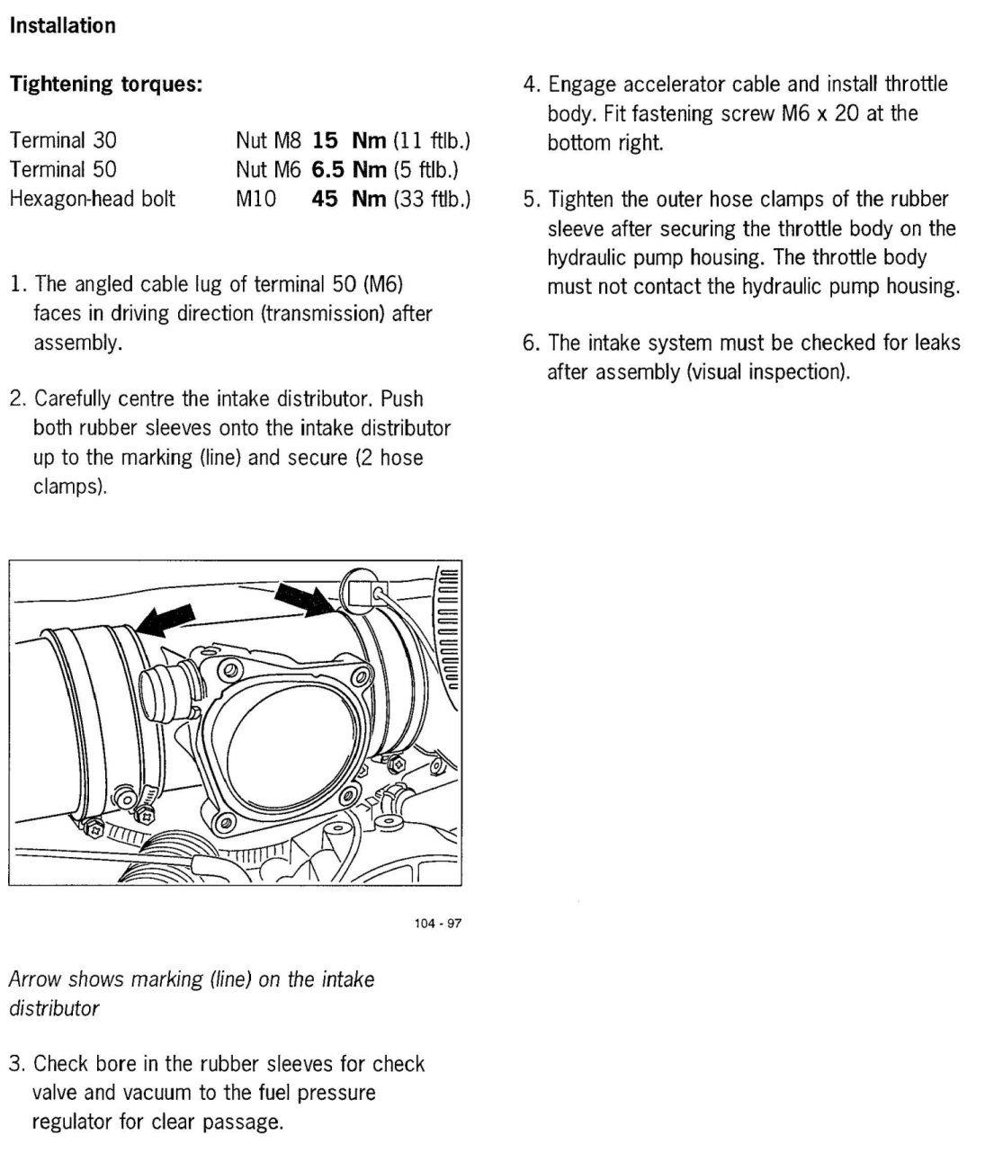

Starter Motor - Here's how to get it off:
