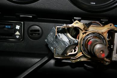

Fixed it
The metal beam that operates the switches (arrowed) had bent slightly over the years, a quick bend back to straight and now the dip switch works fine.
Getting the switch out though !
Various contortions required as the switch needs to be pushed back, but there's not enough clearance between it and the dash.
Fixed it
You need to push back & rotate the switch anti-clockwise to get the clearance, and even then its a bit tight.
Could have done the job probably with the switch in place, but would not have been able to diagnose the problem.
And another thing, the cables do not plug in at the switch, but run through the dash to a plug at the right hand bulkhead, so you would have to open all the cable ties for the loom and pull it through to replace the switch, crazy. Hate to think what the OPC would have charged (the switch itself was quoted at £97)
