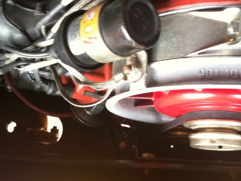

I'm not too sure about these things, but as I understand it the only purpose of the blower driven off the main belt system is to blow fresh air into the exhaust as it leaves the engine to fool the 1980s California emmissions tests. The car still creates the same amount of pollution, but this just diliutes the gas but by adding a slight extra load on the engine, thereby actually creating more pollution for no purpose. If you still have one of these it is your green duty to get rid of it and get a few HP more into the bargain.
This is mine with the parasite removed. You should be able to see the hole bottom left where the old pipe work used to feed through to the exhaust back box....
Thats the air pump Chris, as you say to water down the emission results for California. The electric heater blower fan is mounted higher up above the air pump.
That's right - it's not the "Californian parasite" which you are referring to - but the electric heater blower fan situated at the back on the left just below the rear windscreen motor.
