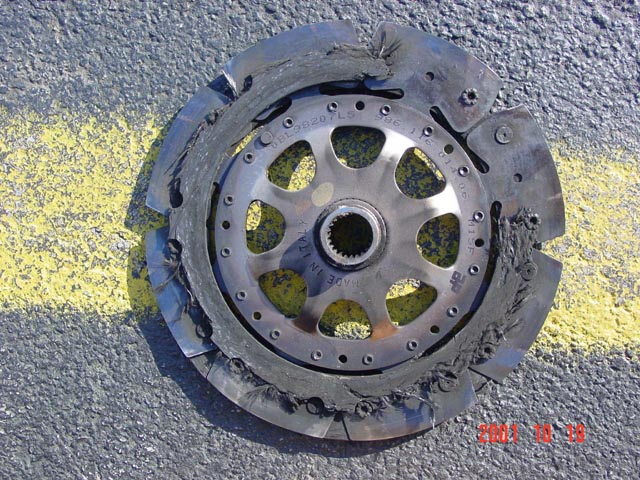

Now this is a disc from a guy that like to autocross....

Ouch! The Autocross picture is very bad indeed, must have put serious strain on the gearbox after the drag racing...[8D]

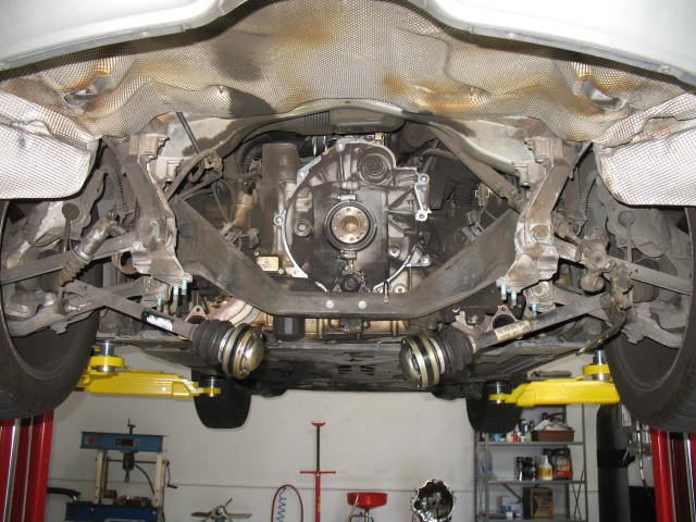

Nice piture of your car with the gearbox removed, did you do the clutch yourself ?
If so, is it a big job to do ?

The autocross guy use to have a website where he bad mouthed his dealership because they would not replace his clutch for free after he abused it. That is where I found the picture. He finally paid for a new clutch. Then guess what - he did it again after more autocrosses and complained all over again.
As for my Boxster clutch, I let a mechanic replace it. I have replaced clutches on other vehicles over the years in my younger days, and would have liked to have done the Boxster myself. But now I am old and the thought of laying on my back on the driveway with the car on ramps did not appeal to me.

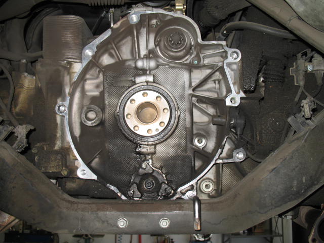

This is the back of my 1997 engine. It had a very slight film of oil, but the black stuff is clutch dust sticking to it so it looks worse then it is. I did not actually have a drip. I consider this normal on a car with 67,000 miles. The mechanic wanted to do the latest reseal. I was against it because of Murphy's Law. In the end I told him to do it, since he was in there anyway for the clutch replacement.

I'm like you, I have changed clutches on other vehicles, but the thought of laying on my back on the driveway trying to line up a very heavy gearbox with the engine (sods law, it will be in the winter time!), but I do love doing jobs myself, I found the 986 to be one of the best cars I have ever worked on up to now.
I agree with you about Murphy's Law, if it isn't broke then leave the dam thing alone !
But as you say, if you got the car in pieces then it worth doing the RMS for peace of mind.
