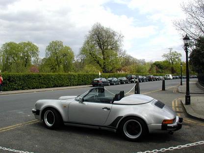

I use to have a 1989 911 Speedster which was maintained by PCGB (at Reading) for 7 years out of the 14 years I owned it.
The car use to average around a 1000 per year and PCGB were more than happy to just do the minor service each year and change the brake fluid every 2 years. They assured me that the car only needed the major service every 12K miles and not every 12 months.
Needless to say the car never missed a beat, I saved 100's of pounds by not over servicing and did my bit to save the planet at the same time [
