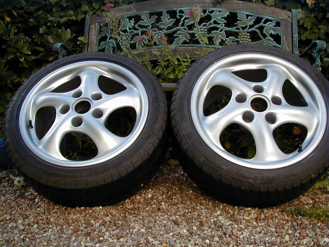

You can mailorder direct from Wurth UK on 08705 987841 as I recently bought two cans of their Porsche Silver spray paint to refurb my wheels.
Now unused if anyone wants to make an offer [:)]
ORIGINAL: Diver944
... as I recently bought two cans of their Porsche Silver spray paint to refurb my wheels.
[FONT=verdana,geneva"] [FONT=verdana,geneva"]There's a story there, isn't there...?[FONT=verdana,geneva"]

ORIGINAL: Fen
[/quote]
I bought them a few months ago planning to refurbish my wheels whilst having a summer rest in between jobs. However, I now don't need them anymore [;)]
Aha. You realise the spokes are bent and there are only 2 of them, don't you? [:D][FONT=verdana,geneva"] [FONT=verdana,geneva"]Back on topic I would think they come off but are a bit awkward. They are in 2 pieces at least which has to help (1 & 4 and 2 & 3). Mine went on before the engine was refitted. One of my studs sheared when it was being torqued up which you really wouldn't want to happen though. In the end a bit of drilling and easy-out work got it without touching the threads and I now have 1 Lotus Esprit stainless one, as that happened to be in the fastener collection and it was evening.[FONT=verdana,geneva"]
