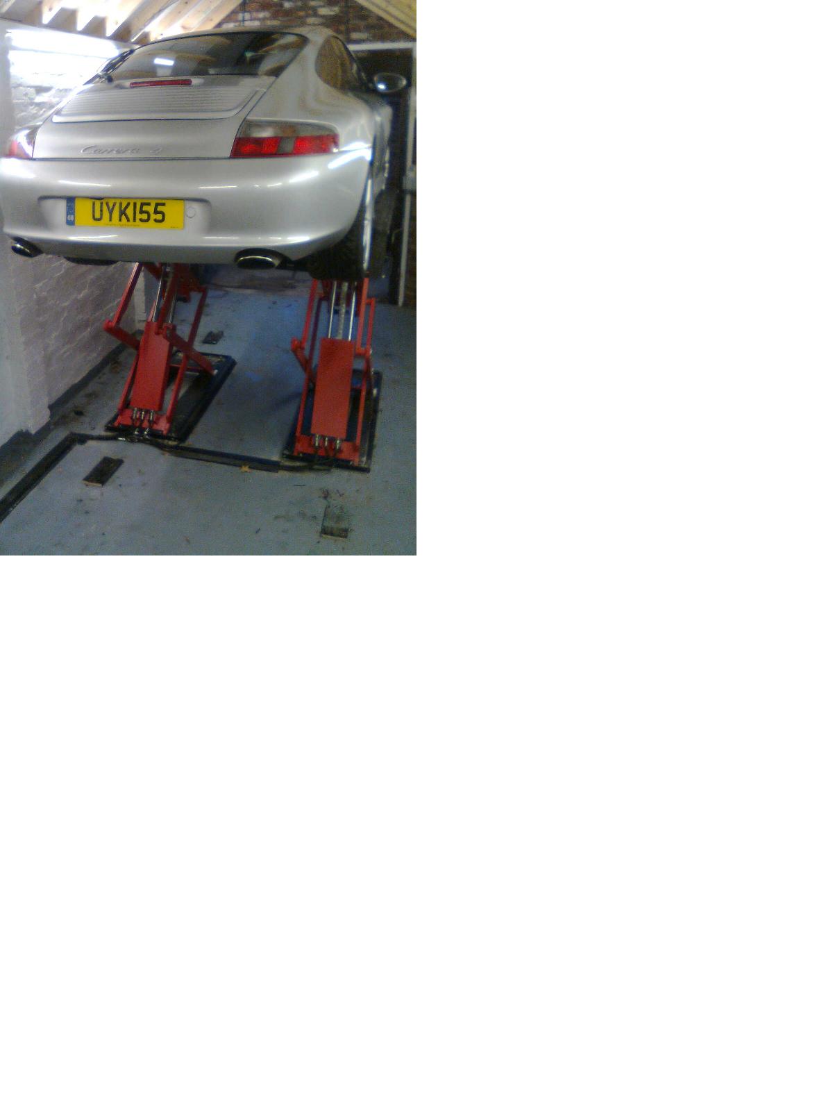

hi i have a set of new headers to fit to the 996 but after having a quick look my nuts look pretty rusty so just wanted to see if anyone had experienced this problem and the likley out come ie snapped studs or stripped threads
any tipps or advice welcome
also i am trying to put a photo on bare with me
Nice lift!
