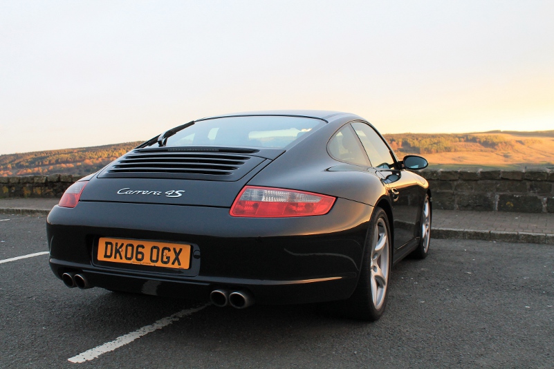

And here's a photo of the lady in question.
Hopefully the attachment worked-didn't on the preview.
