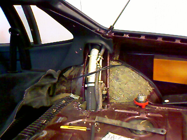

e. access fuel filler pipe inside vehicle (I had to take off the top of the back seat but managed to get away with not removing the rear side window. I removed most of the side panel screws and then removed the carpet, sound absorbing padding -- glued in -- and then prised off the black metal over with two claw hammers inserted at the base. You can try cutting the sealant around the edges but it's a brute force operation.
f. remove fuel filler pipe hoses after numbering both sides of split so you remember how to reassemble

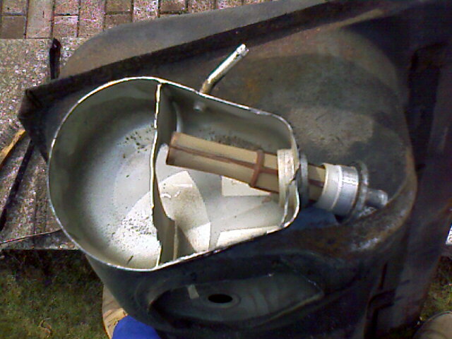

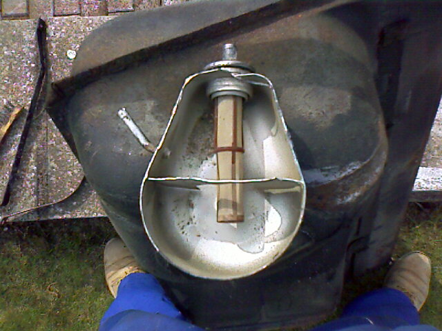

Here is why you need to remove the spout off the base of the tank, there is a filter on the other side.
PS When I angleground this off I was sure the tank was bone dry and still a couple of tablespoons of petrol dribbled out. Health 'n' Safety R Us.
PPS Don't so this to the tank you are planning on putting back in the car :)

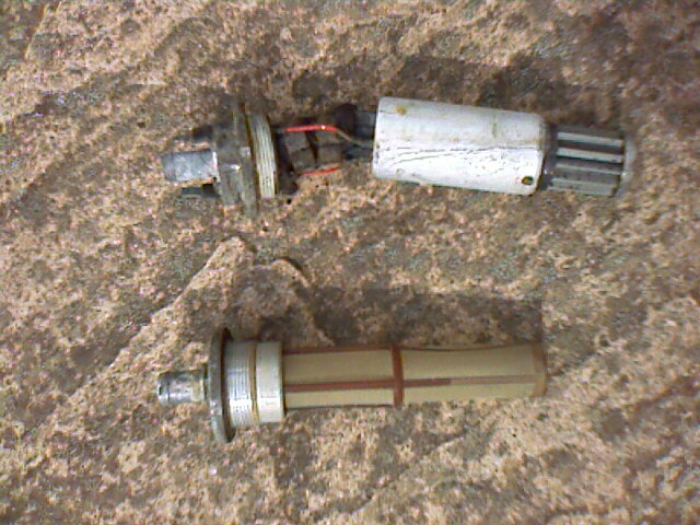

Here is the spout/filter removed from the collector. Note thread. I used a socket from the spout end first time, but a set of plumber's mole grips around the large rim was easier on the new tank.

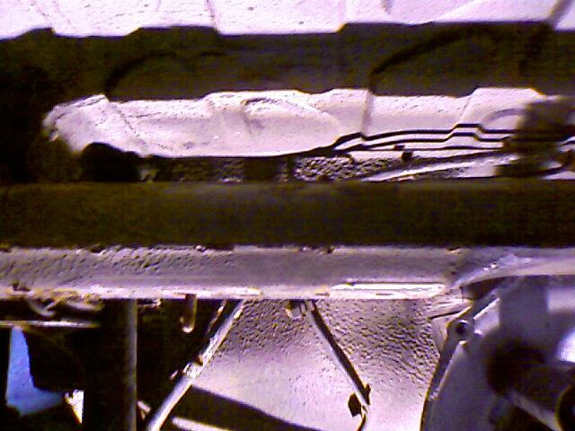

Here is a particularly bad undercar photo of the ledge the front of the metal fuel tank rests on. I also had a plastic tank to hand and was thinking about using that but have been told angle grinding and welding are required (Chris Horton, recent 911 & Porsche World article and an email). I think the angle grinding involves taking the top half of this beam off so that the thicker front end of the plastic tank will fit. Maybe they weld a metal plate on the top of it? It may structurally stiffen the rear of the car so I was unwilling to slash and burn. You will also have to modify the metal straps for mounting the plastic tank. Some wire splicing may be required for the fuel tank measurement sender.I may try this modification on another car once I get my own garage and pit (currently cluttering up my uncle's).
