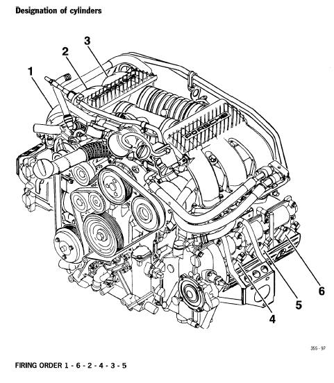

If so, does anyone have a drawing which shows me which cylinder is which. Hopefully 3 and 5 will be on the same side and hopefully have coils and plugs at the easy end.
I have watched a video on you tube and it looks a pig of a job. Any help with a layout drawing/picture would be really appreciated.
Coil packs would be the first port of call for me. Unlikely that the plugs have gone.
If I was at my PC I would post a nice diagram, but working on my iPad you will have to do with this:
Front
3 6
2 5
1 4
Rear

And as Richards diagram, He would have needed to know the firing order.
Many thanks Richard,this helps tremendously.

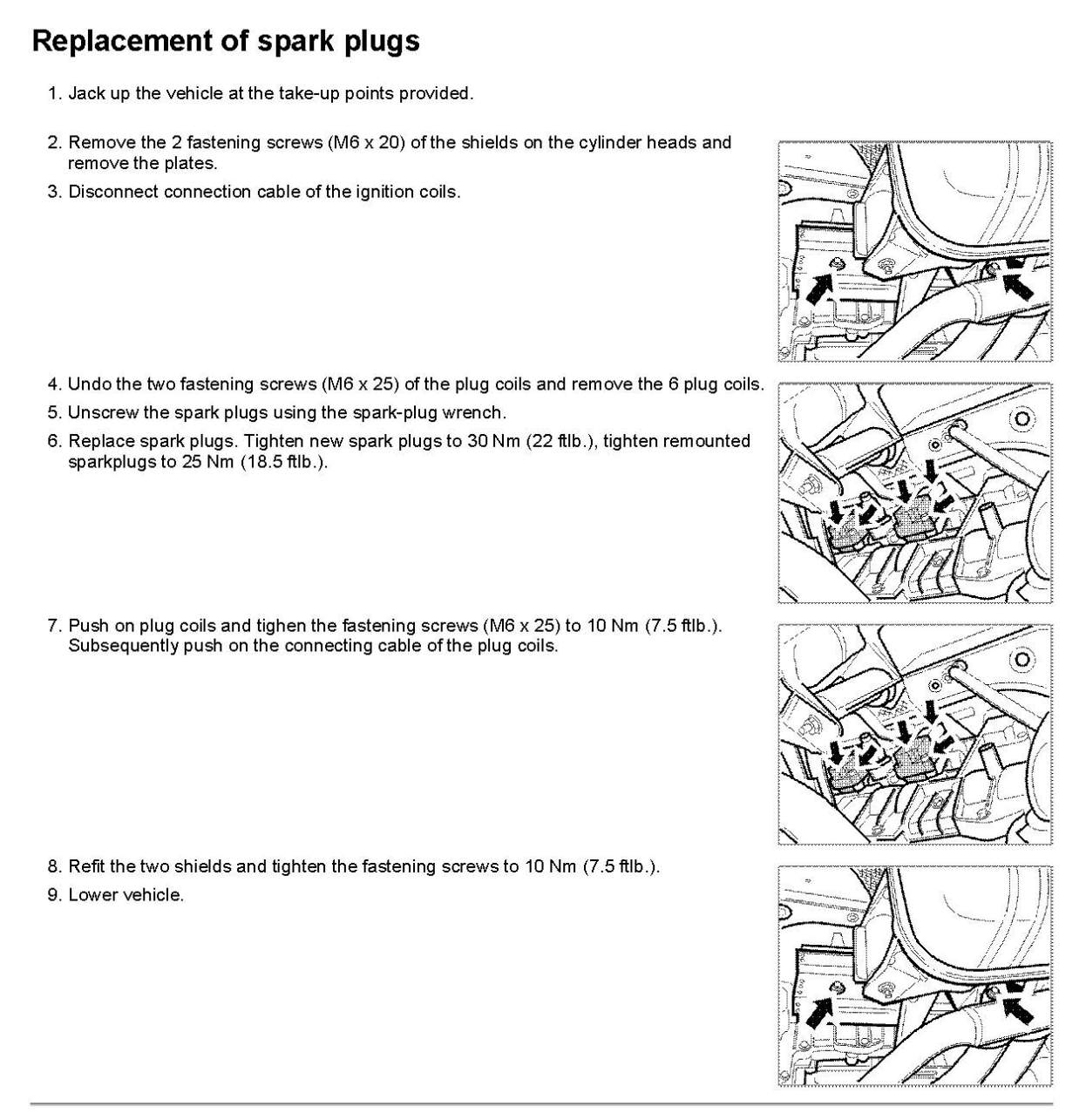

Here are some instructions:
Thanks again to you both. I always thought that the ignition coil and plugs was an extremely difficult DIY. Couldn't believe it when I tried is myself. Job done in no time at all. Mind you, numbers 3 and 5 were probably the easier ones to get access to. Number 5 was cracked in a number of places whereas number 3 looked fairly new. Anyway, both replaced, car running fine and engine light has now switched off so 'Happy Days'.
