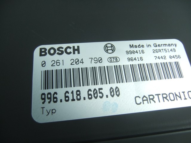

Richard, you're calling the unit a DME - what does that stand for? I've got pics of the unit (attached).
DME = Digital Motor Electronics (or the German equivalent) = ECU
I'm pretty sure that's what your picture shows, but Richard will no doubt confirm.
