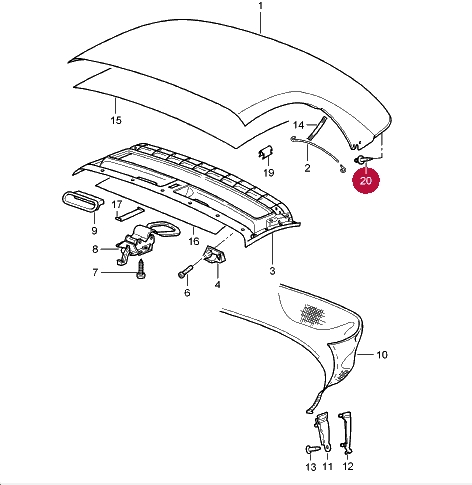

Do you mean part #8 (See pic) ?
If so part number is: 986 561 689 00
Priced at 7.99 minus PCGB discount + VAT
No, it's on the other end of the arm and connects to the hood.

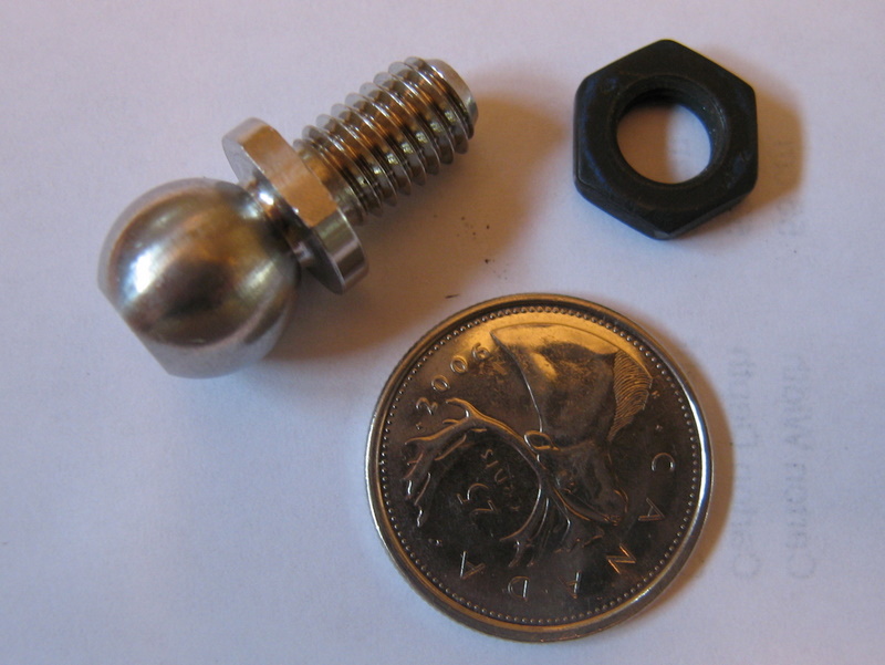

I have a photo of the part from my parts manual ce but unable to upload to this page as system says too large. John
No, alas, I still can't get photo to show up within text but at least the link works.
I've taken a photo of my laptop showing the push-arm which connects to the bolt on the roof fitting. This is off the cd manual but unable to copy page as is read/print only document. Hope that helps. John

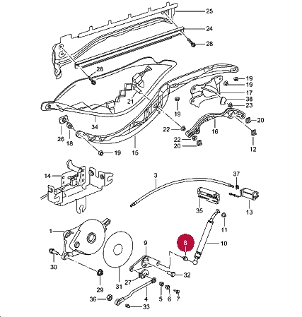

So you want the nut on the plastic frame then (The one the arrow is pointing at in your photo) ?
Edit: If it is it's 33 and 36 on the original part diagram I posted namely:
33: Ball Pin - 986 561 879 00
36: Nut - 011 118 11
Cost: 4.55 and 1.64 +VAT
That looks like it. What's the best way to fit it as nearly impossible to put both hands down between the gap in order to reach location. Is there any way of removing part of the hood framework to gain access. No matter which position you put the hood you can only just squeeze a hand into the gap. Thanks again . John
