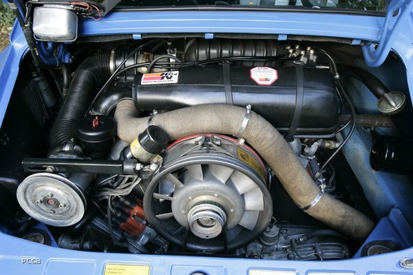

Please see attached photos of items which I think should have something attached
[attachment=image4 (002).jpeg] [attachment=image4 (002).jpeg] Sorry everyone. Took me a while to get the photo's loaded. I think I have done it now.
The 'does it look like this' picture above is the backdated version which does not have an electric fan. The finger you are pointing at
is the holder bracket for the electric fan. You do not show the right side of the engine to see if it has been backdated or is left unconnected.
Usually on the SC both sides go to the electric fan output with the unconnected part you are pointing at going to the fan input.
Fans are quick expensive new. Perhaps find a 2nd hand part or go for the backdate option which will be cheaper.
Thanks Rob, I think everything has been removed, I can see a wiring loom plug in that area which I assume connected to the fan, I think I am going to keep looking until I am 100% certain what I need, I appreciate your reply. Regards Dave
