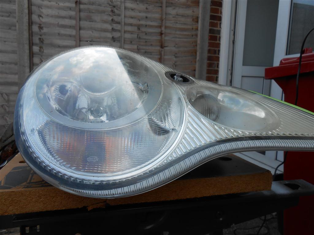

I used the 3M kit on mine. Some pics on this thread. http://www.pistonheads.com/gassing/topic.asp?h=0&f=48&t=1160491&mid=91677&nmt=Porsche+996+Headlights+-+Discoloured+%2Fcloudy
My headlights seem to have a spidery white/ milky residue on the inside. Does that sound similar? As the headlights are a sealed unit, I don't know what it causing it and how to get rid of them. They have the headlight wash too and priced them up c£600 each which seems a little high.
Any thoughts?
