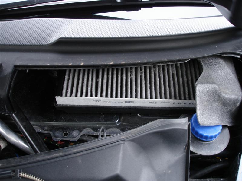

Dead easy - takes 3 minutes.
1) Open boot & remove battery cover
2) Use a T-25 Torx bit to remove the screw holding the nearside plastic cover on
3) Remove plastic cover - it catches on the windscreen reservoir filler cap but can be eased over
4) Under the screen plastic you will see the filter lurking. Pull it out from the centre of the car side pivoting it at the N/S/F corner
Refitting is the exact reverse of removal
Here's mine - as you can see, it's a bit grey & grungy looking. If it's black it's definitely overdue for a change. Leaves etc. will also hold moisture so get rid of any you find.
Nick,
Did you just take that picture, or did you just happen to have a picture of your pollen filter ?? !!

ORIGINAL: Diesel130
Nick,
I'm not quite sad enough to have a picture of my pollen filter lying about. It was a slow day today, so I went out & took the picture [:D]
That's how I know it takes 3 minutes!
