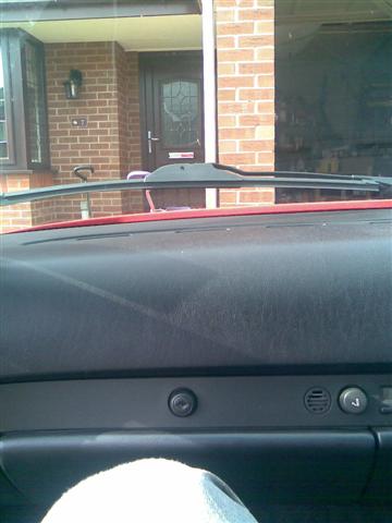

Well I finally got round to fitting the VW Lupo wiper arm and blade today. I've only got one as I wasn't sure if it would fit. The whole idea was that I thought the wipers stood off from the windscreen surface quite alot. One thing i've noticed about these new modern flat blade wipers is that the wiper arm is paralell to the wiper blade rather than over the top, which I thing gives a much lower profile and I hope will lead to less wind noise and better performance of the wiper at speed.
The wipers on our cars are both the same and after much inspection of modern cars wipers I thought the VW lupo GTi drivers arm (not the normal Lupo as they have conventional wipers) was the closest. In actual fact they are very close but are about half an inch longer than the 944 wiper, but there is plenty of clearance on the windscreen.
So I took a chance and bought one arm and wiper blade and today finally got round to fitting to the passenger side. I didn't fit to the drivers as the extra half inch may have caused the blades to clash in use.
The arm fitted straight on no problems at all. The only problem i had was that due to the extra length and the thicker tip of the new style blade the corner of the bonnet clashes with the blade tip when you open the bonnet. This meant I had to fit the arm at a bit of an angle to provide clearance. This is a bit of a shame as I wanted to fit the arm as close to the bottom of the screen as possible such that the arms tucked under the bonner lip as much as possible. I can probably still fitn the arm like this but it would mean the bonnet corner will open above the wiper arm rather than below.
Other than that the install is totally successfull and is a much improved look over the original arms. Once I get the drivers side arm bought and installed it will look even better. Please see the before and after shots from inside of the car that show the newer blade has a much lower profile than the original.
Now for the after. Unfortunately it is from the drivers side but hopefully it shows the effect just as well:-

No, that is what I have fitted on the drivers side which fits onto the standard 944 arm. I wouldn't recommend those over standard wiper arms. What I have done with the passenger side is to replace the arm completely with a VW Lupo GTi drivers arm and blade. What the photo shows is that the arm is paralell to the blade and hugs the contour of the windscreen much more closely. The standard arm sticks up over the top of the blade a good half an inch or so taller than the lupo setup. This means the wiper blade is much more in the airflow coming off the bonnet causing noise and reducing the wipers perfomance at speed. The whole idea was to get a much lower profile wiper setup that tucks under the line of the bonnet. I think with a bit of playing around the Lupo arms and blades will give me that. Even though the blade itself is quite bulky it the whole setup is much much lower profile that the standard setup and i'm confident will work much better at speed as a result.

The new wiper is still only installed on the passenger side and though i've not used it in anger, though it seems to work very well when I use the windscreen washers - certainly no juddering. The spring on the arm seems to be much much stronger than the old one - but this could be due to the spring weakening over time. From the inside the whole wiper arm looks very low profile as the wiper arm dissapears behind the wiper blade. The highest point off the windscreen of the whole thing is now the thickest part of the wiper blade. The arm really does hug the windscreen very closely.
One slight concern, at the very root of the arm there is only very very small clearance of the arm against the screen. It doesn't touch at any point of it's operating arc. I think I wont have the same problem on the drivers side as the curvature of the windscreen is falling away from the wiper as it moves through its arc therefore increasing the gap. I've not done a test fit of the passenger arm on the drivers side as I want to minimise the removals and refits of the arm to keep the spline as tight as possible.
