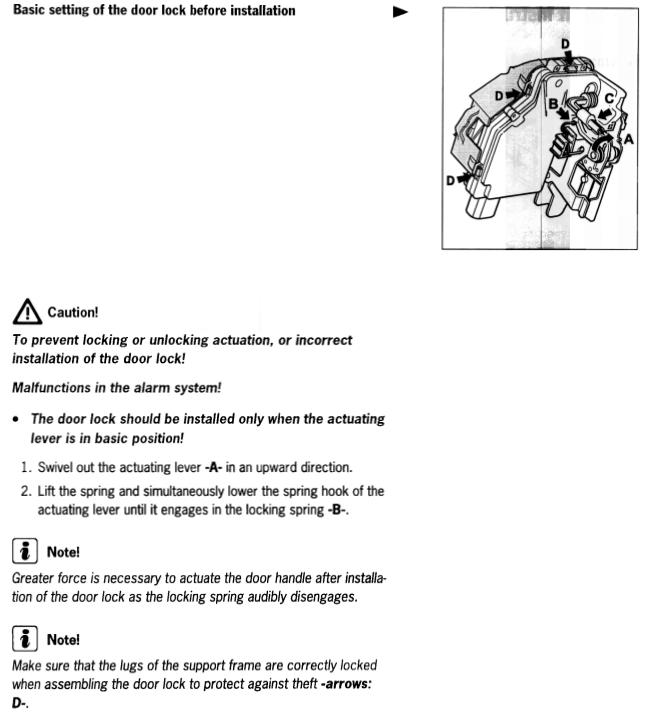

When you fit the door lock, you have to be very careful to engage the blade on the key barrel into the lock assembly before bolting it to the door. My guess is that they didn't do that. It is quite common.

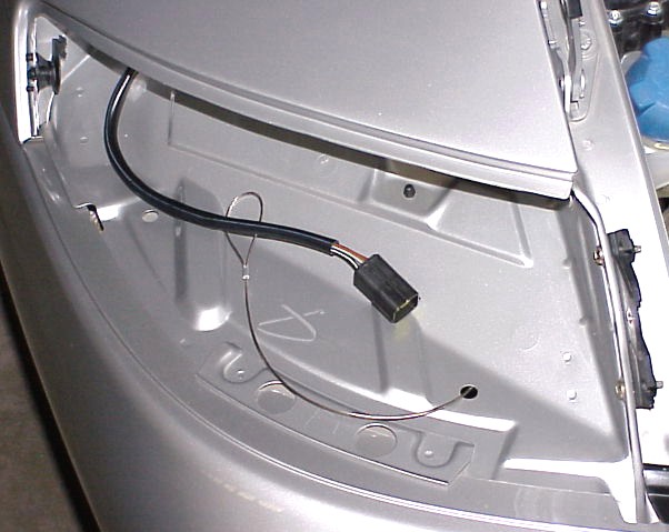

If your car has electric lid releases, then the emergency locking cable is underneath the headlamp mounting tray on the driver's side. You can access it by unclipping the front of the wheel arch liner, and putting your hand inside, and grope around for the cable. It is a steel wire cable with a loop on the end. It won't be easy, especially if your front wheels are pointing the wrong way.
As soon as you pull it, not only will it open the lid, but the alarm will go off. This, if you are lucky, might be enough to wake up the system enough for the remote to work. (I will certainly have woken up the neighbours!). If not, you will have to disconnect and reconnect the negative terminal on the battery, so have a 10mm spanner ready.

Yes, if it has mechanical release levers, then the emergency cable is on the passenger side. It is a grovel at the best of times, but you will have to peel the front of the wheel arch liner back to have any chance of reaching it. There is a plastic expanding rivet you need to remove in order to do that, and I doubt you will be able to get to it.
I have an idea, but I don't know if it will work. Behind the rear passenger side light unit, there is a release cable for the rear lid. You can get to it by fishing around through the gap at the base of the light with a wire hook. If you pull the wire, it will release the rear lid and set off the alarm when you lift it. This MIGHT wake up the alarm sytem, and you MAY be able to unlock it with the remote. If not, it will definitely wake the neighbours, and the alarm will sound for a few minutes.

I've managed to peel back the wheel arch liner on the passenger side enough to see up to the back of the headlight but couldn't pop the expanding rivet in line with the axle so it wasn't ideal. I couldn't see the cable. The garage sent a mechanic over this pm and he spent some time trying to find the cable on the driver's side. They're adamant it's on that side even though I've told them you've said it's on the nearside. He gave up after a while and has arranged for the car to be trailered back to the workshop on Tuesday. Quite how they think they're going to load it onto the trailer I don't know.
I've found out that the barrel of the lock wasn't changed, it was just the assembly with the micro-switches in. The garage have said there's nothing to do to the lock other than re-connect it to the alarm/central locking implying it's not their fault. Is this correct? It's too much of a coincidence this has happened following the change of lock. Referring to my ancient workshop manual it seems to be a bit more complicated than that...

The key barrel (in the door handle) isn't removed when you change the door lock assembly. On the back of the barrel is a blade, which engages in a slot in the lock assembly. It is easy to refit it without engaging the blade in the slot. Hence your problem. A Porsche garage, eh? Better not say which one........
And I can guarantee that the cable is on the passenger side if you have release levers. Unless you have a LHD car, of course, in which case it would indeed be the driver's side. Unless someone has re-routed the cable, it should be under the headlight tray, close to the inner wing. You really have to grope around to find it. It has been known for some people to re-route the cable to behind the sidemarker light, so that they can simply unclip it to access the cable.
