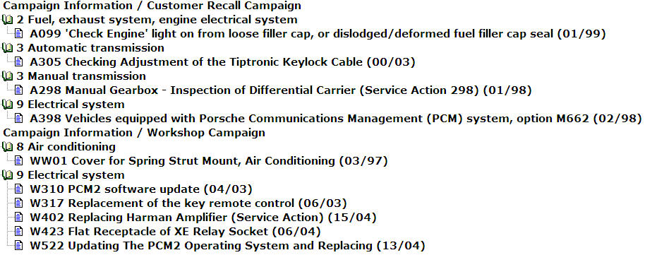

Just talking to my local OPC about the possibility of getting the RMS replaced FOC. I said I had seen a lot about it on various forums, I was asked if I knew the capaign number! not sure what it is can anyone help.
Thanks, Timbo
Porsche have two types of Campaign:
Customer Recalls - safety recalls generally, and the Campaign number starts with 'A' followed by 3 digits.
Workshop Campaigns - generally minor updates that aren't safety recalls. The Campaign number starts with a 'W' followed by 3 digits.
AFAIK, there are no Campaign numbers for the RMS. Any campaigns completed should be stamped in the Maintenance Booklet. Not all the attached will apply to all models.
Just had mine done under warranty. The dealer said that Porsche are usually sympathetic with RMS out of warranty.
