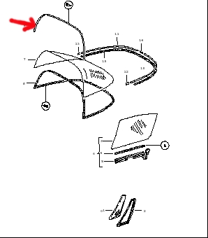

My query is this - anyone know what this "seal" is officially known as to enable me to buy a replacement - can't see it identified on any exploded seal type diagrammes (it's there, but not identified unlike the rest of the rear window seals.

I've dug out an old parts book that I have. There's a part called a "Rear Bar Seal", part number 901.565.930.41 for 1968-89 Targa with rear glass.
It appears to fit between the rear of the roll bar and the screen. Is this the one do you think?
Do you mean the 'ribbed 'seal in the diagram?
Yep that's the one - found one at Type-911 in Bromley (bargain at £18 !). Should help keep things dry - can't help thinking that the main window seal must be on it's way out though.......
