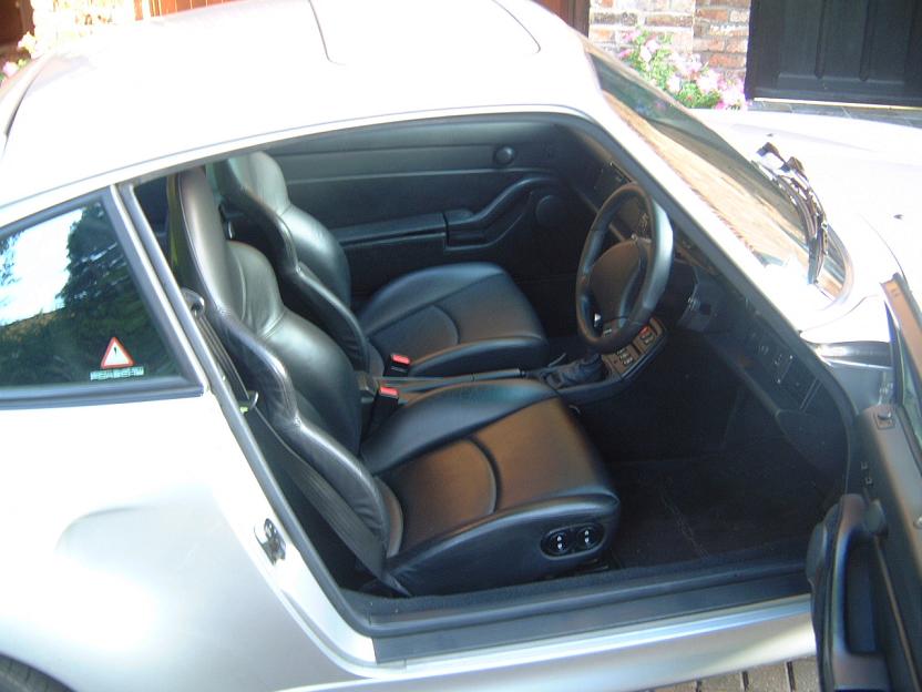

Moved my driver's seat back to the "rear" position today (it's only an extra inch leg room but I've been meaning to do it for 18 months).
Anyone else done this?
I ask because, having seen that there are bolt holes for this when I had passenger seat out to fix a rattle ages back, when I moved the driver's seat today I realised at the last minute there is no hole for one of the bolts (the rear most of the two at the back of the seat by the transmission tunnel). Or is there some clever trick I have missed?
