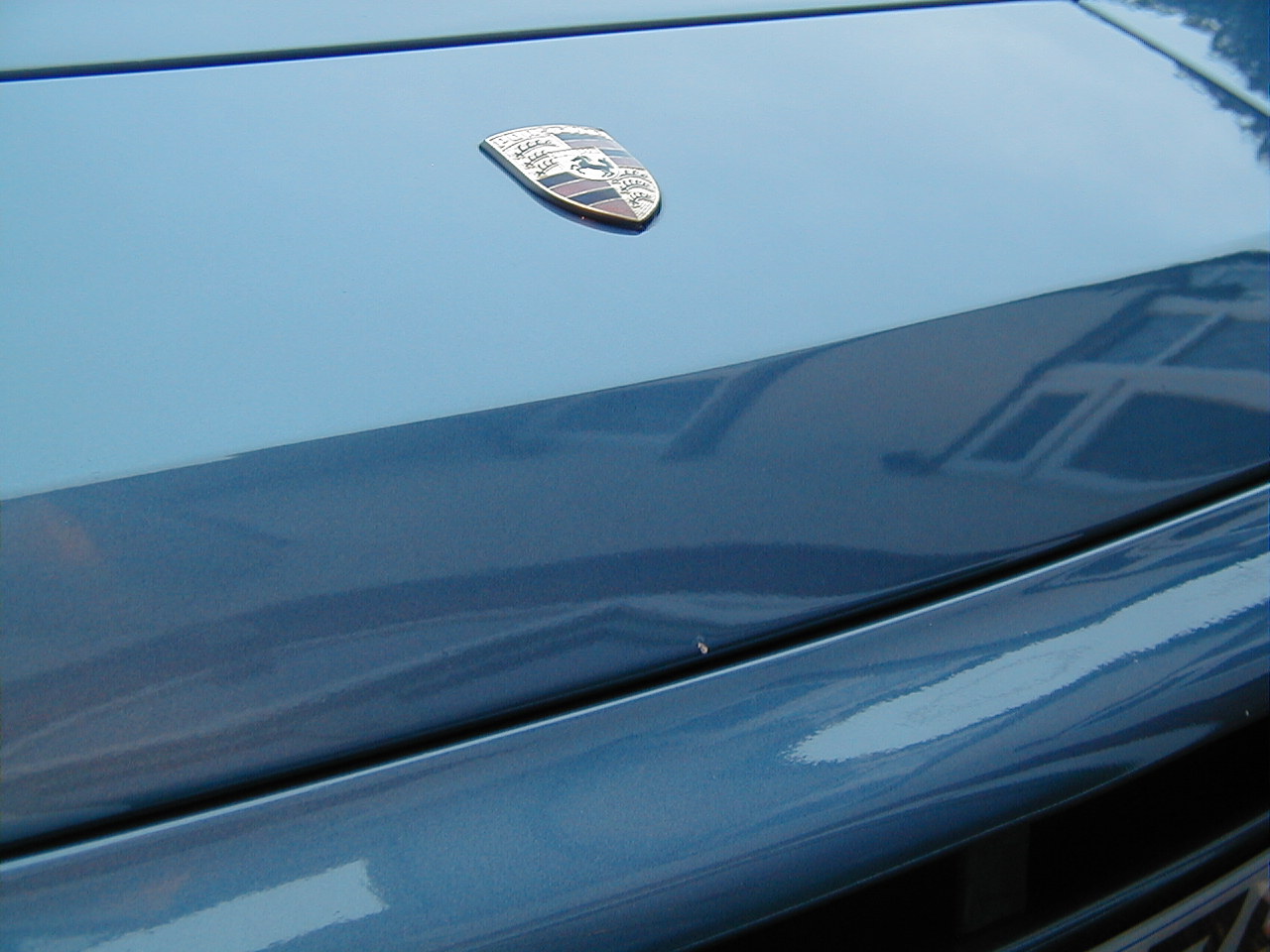

As regulars will know I had my front PU resprayed in October to address 15 years of stone chips.
Today I can proudly [&:] display the first new chip
The cruelest chip of all [;)]
Paul, would you mind saying what you paid for the respray? I'm considering having my S2 for the same reason - 15 years of chips on black is pretty noticeable after clean-and-shiny-ing.
It was £300 [:)] for the front end and a lot of small bits. All the details are in this post:

Bummer about the chip, Paul. Paint job looks spot on from the pic though.

You could fix that with the right shade touch up paint and Langka
www.langka.com
Cheers Mark,
I do have some Langka, but I'm going to leave it a few months until the new paint is totally cured before I start messing around. Chips are a fact of life when you commute up and down the motorway every day so I'm not overly upset. It still looks amazing compared to what it did 6 weeks ago [:)]
