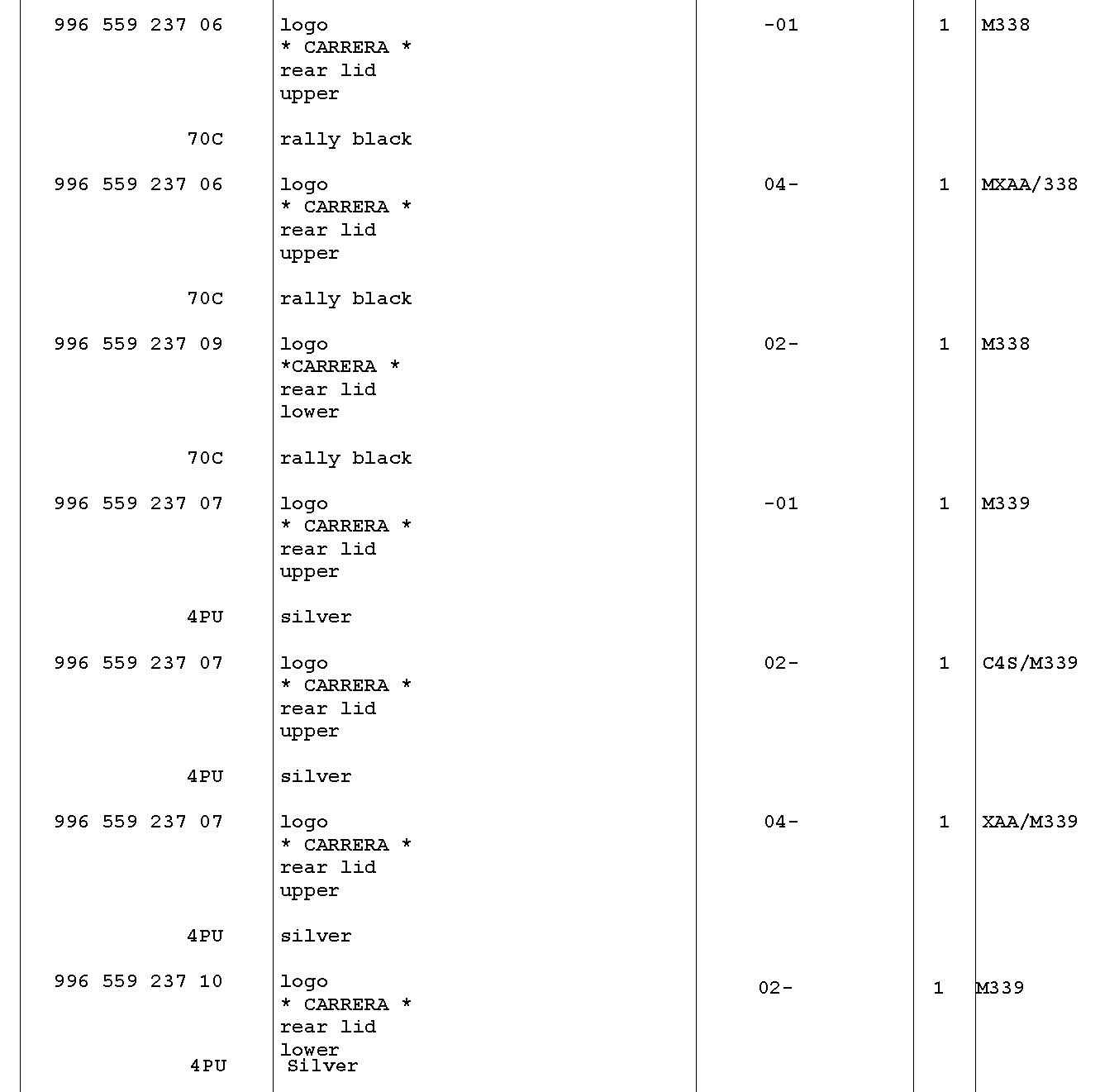

Did you get the correct badge? There are different part numbers depending on model year, and I expect the curvature is different, depending on whether the badge goes at the top or bottom of the engine lid.

Looks like i may have to buy another badge then ! I got it from Porsche shop so i just order a black badge. It didn't give me an option from what i remember, plus i didn't remove the wax either so that's probably not helping. Good job the badges aren't that expensive!
