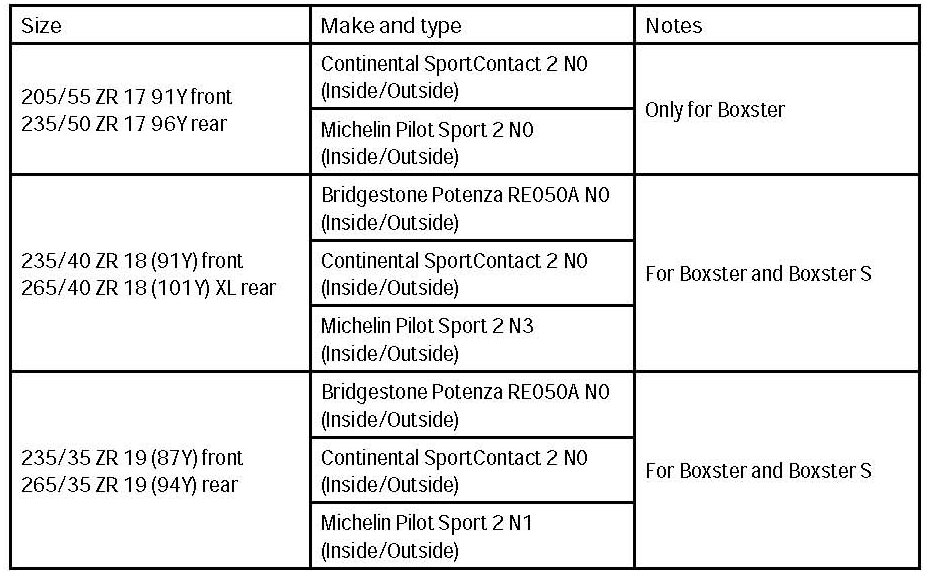

Here's an extract from the TSB which lists the approved tyres.
Edit: For 986
