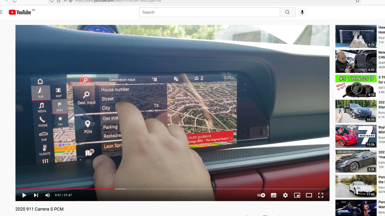

Does anyone know how to configure PCM Destination Input to show House Number, Street and City as per this image (for UK and Europe not US)
