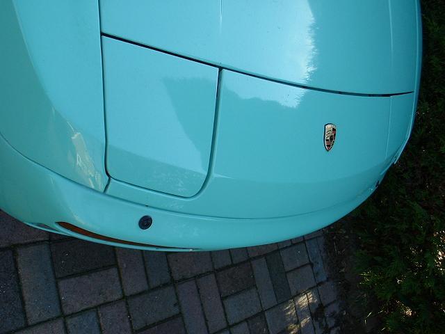

trying to post picture - computer hates me
Amazed that worked. First time for putting a photo on a site. Not the best of photos, but hopefully one of you cleaver people can tell what wing spec. to ask for.

The body is not 1990 it's pre '85.5; it has the 924 style windscreen.
I'm not aware that there is any difference with wings over the years anyhow, you either need a Lux wing (like your's) or an S2/Turbo wing.

The Lux and S2/Turbo wings are different shapes at the front where they hit the nose section.
Much will depend on which type of nose you have. There is an aftermarket kit available which has a GRP nose and retains the original Lux wings. (Porsche S2/Turbo front sections are made of PU not GRP). I would anticipate that it is this that has been fixed to your car as the lower lamp clusters look non standard.
If you could post some more pictures of the front corner, where the wings join the nose, this might help.
OK. As John says it's the front corners of the wings that we need to see.
I still stand by my original statement though that there are only 2 types: Lux and S2/Turbo and they are completely different at the front so it will be easy to tell if you post a pic of that part of the car.

If it helps the Turbo/S2 wing has a fairly gentle swooping curve where the wing meets the nosecone whereas the Lux wing has a sharp right angle where it meets the bumper.
Your badge panel looks like a lux ( flatter in the middle of the front edge)

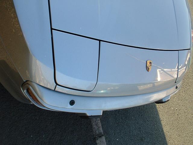

I will post pics of my lux & Turbo later

Thanks Flamingeye for your photos. My wing is the same as you red car J459. Next stupid question - what model is that?
That is an 944s2 wing then.

BTW Turbo / S2 fronts were launched in 1985 but only on cars with the flush windscreen and oval dash so yours with the original 924 style scren (and dash I imagine) has been altered. That's what you said all along of course and I admit I was unconvinced at one time [8D]
Thanks very much folks. Yes Fen - 924 screen and dash.
Now I know what I'm looking for - 944s2- Hello ebay and scrapyards.
