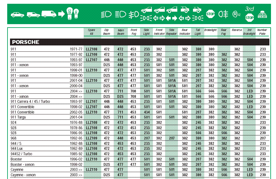

Hi guys, does anybody know off the top of the heads all the type of bulbs (IE Side lights and courtessy = 239) I would like to know rear normal and Stop lights, indicators front, rear and side repeaters, and rear fogs.
Bit of an obscure one, but you will get bragging rights!
All the best.
All you kneed to know about porsche bulbs ...... yawn!
