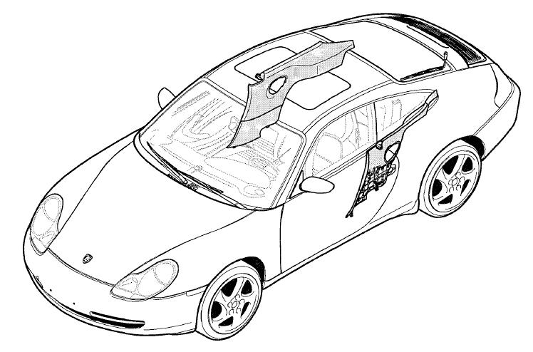

Unless it's way back above the arch, perhaps you could remove the side trim panel:

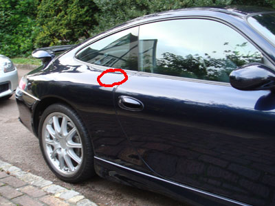

Neil, that sounds ideal - I've attached a picture showing where the dents are, is this in roughly the same place as yours?

Hmm, not quite.
Mine was very slightly further back, toward the rear of the car, and marginally further down, closer to the bulge of the wing.
As I said earlier, it should be easier to access the dent on a coupe, and to be honest, although the dent's not in exactly the same place as mine, I reckon they'll get to that w/o too much of a problem.
