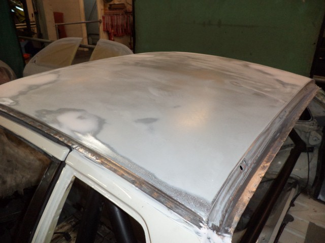

Hi, i put a second hand 924 non sunroof skin on my 944 s2, no major problems.
Here's another showing front profile. All the sunroof support structure is removed so it is just like a non sunroof car.
A good body man would be able to remove the roof and make a new non sunroof roof. The curves on the roof are not that complicated. But you would have to find a proper body shop and not just a accident repair center. My friend could do this job for you.
