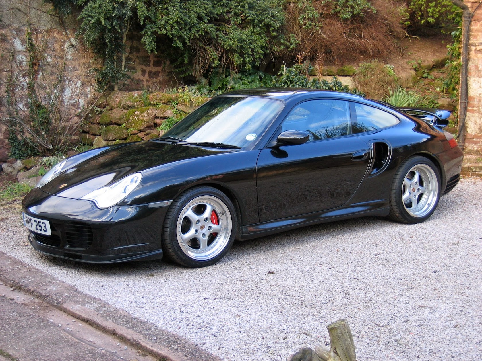

Very happy owner of this Carrera 2 996:
VERY much in love with the Porsche Sports Exhaust (just rude!), impressed to hell by M030 Sports suspension, PSM backup always welcome, bonus GT3 bodykit and she even has my favourite "carrera" wheels. Perfect spec. for me.
Not my first 996; I had a Turbo back in 04 - you may see the resemblance? That car was too fast, too frustrating (everyone in the way) but I'm glad I did it. Actually prefer the Carrera.....the steering is sublime and the noise fantastic.
The Turbo's Carbon interior was worth almost as much as I paid for the Carrera......[8|]. You got to love depreciation.
