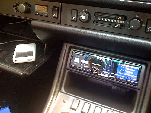

Just fitted the new alpine X100 ipod receiver (no cd player). and WOW! it's rather fab!....I'm without doubt going to get one for the lotus too. easy to install and found a grommet at the back of the glove compartment to push the cable through so the ipod can sit in the glove box. nice and clean compared to all the wires I had out front on the sony system I had.
Also fitted Alpine 6x4's all round as well, there rears were easier than i thought by lifting the rear panels up to get access. Top tip is to have a few sizes of angled screwdrivers (halfrauds £2.99)

Were the Alpine 6x4s a straight fir in the front or was there any messing around because of depth etc?
I assume you have the wire mesh speaker grilles on your S2.

Yep the Alpines are a straight swap for the originals fronts took 5mins and rears to 30/40 minutes and a slight loss of blood, but nothing major, I'll be fine[:D] and yes I use the standard grilles, just resprayed them with halfords semigloss black and they came up really well.

I've not tried it yet, but as the system was out of the dash I made the point of adding the USB cable and also put it through the grommet into the glove box..I just haven't got a pen drive with any music on it at the moment.
