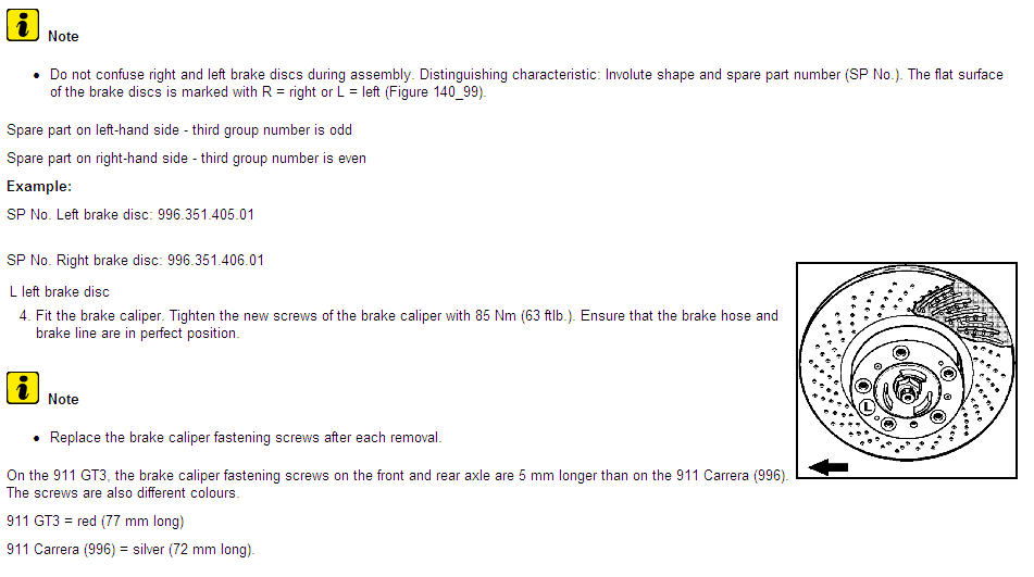

Yes, it is important. The attached shows which way round they should be:

There are left and right handed parts so two different part numbers
For the std C2 & C4
Left 996.351.405.01
Right 996.351.406.01
The rear only has a single part that fits both sides 996.352.401.04
