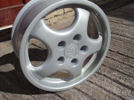

I have bitten the bullet and had my mags refurbished by Steve Turner at TPCS, and I have to say I have been very pleased with the experience and the results.
Steve was great to deal with and sent me regular updates and pictures via email as the process progressed. The wheels were stripped, blasted, crack tested, chromate treated and hot powder-coated, and shipped back to me for £395 all-in. Steve was unhappy with the finish on one of the front wheel lips which had some pin-holes in the powder coat which he could not correct, despite re-doing the wheel, so he gave me a 50% discount on that wheel, which I felt was more than reasonable, and the blemish on the lip is pretty insignificant.
These wheels, as others' experience will testify, are extremely difficult to refurb well, and I'm pleased with the results achieved. The one slight area of question is the colour. Steve only has one silver powder coat colour and it is a relatively dull (as in opposite of bright) silver with quite a high metallic fleck content. I have not been able to compare against factory finish, but I think a trained eye would spot the difference. That said I do actually rather like the colour, with the metallic fleck adding an interesting twist. Any imperfections are not filled as these areas tend to fail and blister, so there is the odd nick inside the wheel barrels, which I feel is acceptable.
The finish itself has a very slight texture to it - not totally glass smooth, but not unpleasantly or worryingly so - may be a consequence of the metallic finish. The lettering on the rim is still very sharp and legible (in fact more so than the previous refurb I had had done) - I know is an area of concern for those considering powder coating. The contact pads where the wheel touches the hub were left free of powder coat, and the wheels were beautifully packaged for shipping - really good attention to detail.
Overall this was a very good experience. As a one stop shop, where the magnesium is treated properly, with excellent, prompt service, at a very reasonable price, I would be happy to recommend Steve. Clearly time will tell how the finish stands up, but I have every confidence it will be 100 times better than the previous refurb I had.

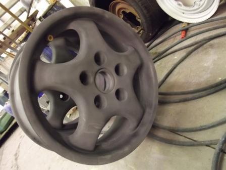

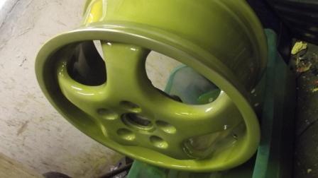

Here are some pics.......
1.) after blasting
