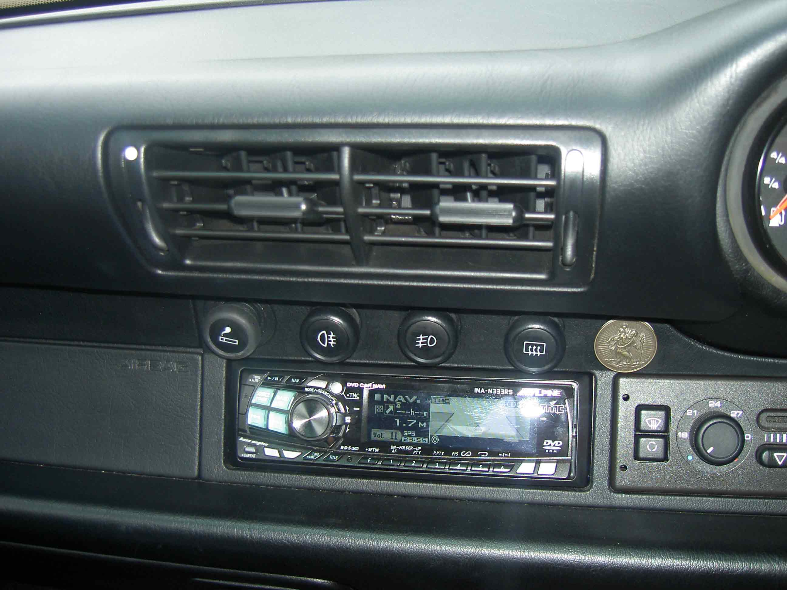

Joe, just thought I would respond re the Sat Nav and Speed Camera question. I have the Alpine INA N333RS (1-Din) DVD system which is excellent. Given that it is only a 4 digit postcode search (although I don't have the very latest disk and am not sure if that has changed), it sometimes struggles with addresses that don't have a number (eg Country Houses.) I am keeping the car as original as possible and did not want to change the look of the interior to any great extent. I personally don't think it looks out of place but Sundeep thought differently and went the Becker route.

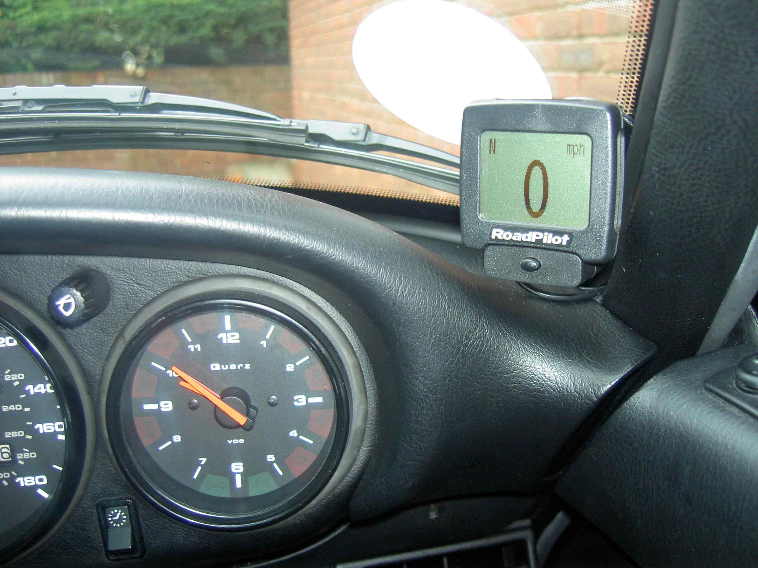

Re the Speed Camera issue, I did not want a large gadget sat in the middle of my dashboard. I therefore went for a Micro Road Pilot. This fits perfectly in the corner of the dash and attaches to the windscreen. It merges perfectly with the cowle over the instruments and the wiring is lost down the same hole as the aeriel wiring so you have virtually no wire showing. I now use it as the speedo as it is far easier to read than the gauge. Once a week or so I take it off the mount, plug it into the computer and get the latest update - it is a fantastic device which I am very happy with. I have also got the laser detector mounted under the front number plate .... had a few false alarms and might have to take it off it they change the law, but it's staying for now.
I'll take some pictures when I am in the car tomorrow and upload them.

Joe, pictures (at last) as promised. GPS receivers are hidden under front PU so no silly black squares visible anywhere. If this works, this will be the Road Pilot ... next message is Sat Nav.

Mark, to give you a fuller picture, I wanted to upgrade the whole Hi-Fi system and incorporate Sat Nav at the same time. I looked at an enormous number of options over about 6 months and then dicussed them with various installers over another 3 or so months.
What I went for is the Alpine INA N333RS linked to a CD/MP3 changer positioned in the spare wheel (hence no loss of luggage space.) The DVD for the Sat Nav is in the head unit so there is no separate box. The front speakers are JL Audio XR's run through a Genesis amp situated under the front passenger seat. The rears are Boston Accoustics run off the head unit. I also had the Micro Road Pilot (+ radar) and a Parrot Blue tooth handsfree car kit installed at the same time - the car kit is run through the head unit and just the rear speakers so it mutes the hi-fi when in use.
I was particularly fussy about everything (eg original look to car, no wires showing, no loss of luggage space, no "black squares" from GPS receivers etc etc) and ended up using a man called Ben at The Sound Gallery - he had worked on 993's before and was the only person to suggest using the grommet for the aeriel to loose all the Micro Road Pilot wiring. They also had a Lambo in when I first went up to see them!
... so to answer your question at last, there is an awful lot of wiring coming from inside the car that is finding itself through the front of the car (the battery, the front PU and the number plate) - the wiring is all neatly fastened under the fabric/carpet cover under the bonnet.. I therefore don't think it was very difficult to get the cabling to the front PU, but maybe more difficult to get the little black squares under the PU - the PU was not removed though. I must point out though that I did leave all the instal to Ben and his team.
