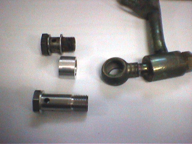

Oh and here is how I (well my Brother) sorted the turbo cooling connection on my bigger turbo.
The longer bolt and spacer allow enough clearance,
Tony
It is just such "Ah..I wonder how we are going to get around this?" solutions that should be noted by respected tuning parts suppliers with proprietary solutions provided.
But then if it was easy any body could do it.
