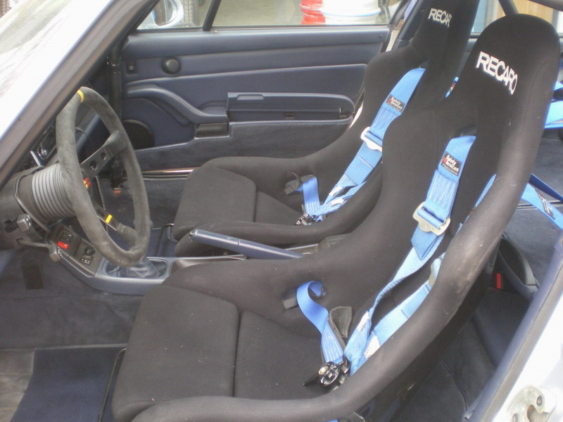

Here's a link to brief details of when I fitted recaro pole positions:
http://boxsey.blogspot.com/2010/02/recaro-pole-position-seats-fitted-jun.html
The side mounts allow them to be fitted as low as they can go when using sliders (can only just get my hand underneath them at the lowest point.
Steve

There is loads of head room for me but I'm only 5' 6". A friend who is 6' has driven it with helmet on with no problems so I think you would have enough room.
The harnesses you've seen were bolt in. So they fitted to the normal lower B pillar point and the two rear seat belt points for the shoulder straps. These were routed over a harness guide bar that fits between the top B pillar seat belt mounts. The inside lap belt attached to the left mount which has a welded nut for the normal seat belt receiver (Nb. This is a special feature of the Southbound mounts - normal recaro mounts don't have an attachment point so you have to buy a bracket for the slider). The bolt in harness came with spacers so that both the harness and normal seat belt could be attached to the same belt holes.
I've just bought some much better new Scroth harnesses. These were supplied with eye bolts that will simply replace the bolts used to attach the normal seat belts. The harness will then just clip in and out as I need it. The only problem is the inside mounting point because there's not enough clearance between the seat mount and the tunnel for it to simply screw in to the welded nut. So I've bought spreader plates so that I can attach it to the floor mount or rear of the side mount (I'll need to drill a hole). Nb. To be FIA approved for racing the inside eye bolt would be attached to the tunnel via a drilled hole and a spreader plate welded on to the other side of the tunnel.
Harness bars simply bolt to the upper B Pillar seatbelt 'pivot' points.
I borrowed one for track use, from Don Traver's RSA when he was visiting.
Worked well, so I bought a Brey Krause one from PorscheShop.
Now I can fit the harnesses in 10 mins and remove them for normal use (with the kids in the back.....).
For the lap belts, I have loops already installed on the tunnel (was previously owned by Silverstone Circuits.....).
The Recaro PPs offer loads more headroom, as I've now got normal hardback seats and found it weird to sit so high.
Quite narrow, but very comfortable (I did Lux to RPM Cheddington and back in 2 days - about 800miles round trip...no issues).
Only removed them to get access to the rear seats.....PPs go back in for the trackdays [;)].
Hope this helps some.....
Jon
