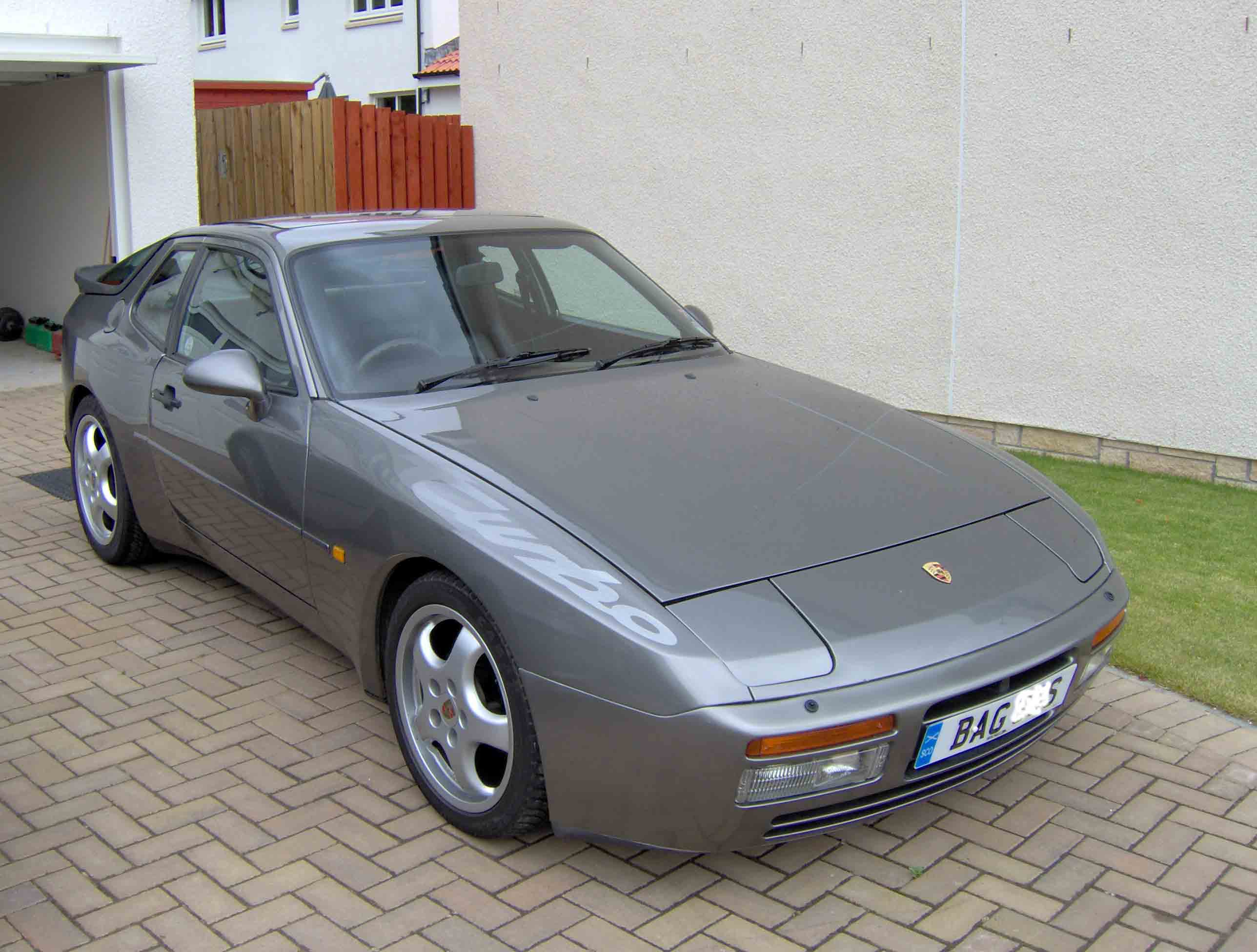

Thats cool, had a few RWD drives when I was young (2.0 Cortina, good sidyways), although nothing with this amount of go, heres pic of new baby.
Very nice, lovely unusual '86 colour. My exp of 220's v's 250's is the 220 engine is sweeter, and I am told it may be forged rods plus immense attn to detail in early turbo production.
