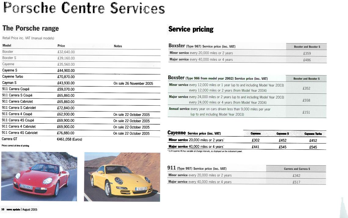

Duncan - OPC Service Costs:

The thing you'll probably read most about is the RMS failing. Although you've got a good chance of that being fine, if it does go £600-700 usually sorts it. Servicing at an OPC can be pricey, go to an independent.
Annual service from one of the many well respected independents is £150-200 and that includes an oil change.

My old 2001 2.7 was a very reasonable car to run given the nature of the prodcuct. Menu pricing servicing makes the costs reasonably easy to forecast, and on my car (bought new in May 01, sold in June '05 with 55k miles) NOTHING broke, failed, fell off or wore out other than normal consumables.

There's a big service at 48,000 but even though I always got mine serviced at the Porsche OPC I don't remember it being a second mortgage job.

My top tip is to get the car serviced at your local Porsche Centre and then use any of the plethora of reputable Porsche specialists to get any non service items looked after. You will be surprised by how reasonable costs will be.
The big service is 48k or 4 yrs..
Normal service + polyrib belt (for aircon/pas/alternator) + spark plugs + brake fluid (every 2 years)
