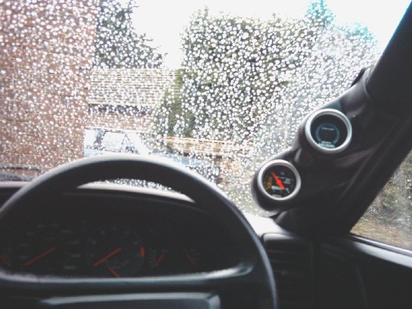

I'm thinking mine will end up in the glove box TBH, along with an AFR gauge and maybe an EGT gauge.
I might fit it in on its own in an A-pillar pod, but I'm not all that keen on them and more than one gauge on the A-pillar is a definite no-no IMO.
I disagree with Fen, they give important info so require a quick glance often IMHO, usually when travelling quickly[;)]

After much pondering I have now relaocated my boost guage from under the radio, where you can't realy see it when full boost is happening, to the door pillar.
Whilst I had considered a pillar mount shroud affair I ultimately oppted fo an off the shelf pod with a bespoke bracket. Initial road tests have shown the pod to be nice and stable and idealy located to view whist exciting things happen. I didn't realise how much the boost bobs up and down. [;)]
I quite like that - enough that I think my boost gauge can go on the pillar. Only one gauge there for me though, and I'm keeping most of my cubby under the radio so I still have a problem with any extras.
I agree that one is enough. Any more and (IMHO) the guages start to get very close to your face and necessitate considerable changes in focal length to view. With one guage it is, pretty much, in the same plane as the instrument cluster.
