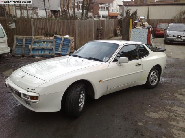

new to this place and to Porsche ownership... well technically i'm not even an owner yet. Coming from owning an E46 M3 (which I'm keeping, the Porsche is to go alongside it)
I have put down a deposit on a F plate 1989 944 2.7 Lux in white with teledial alloys, half leather trim. Car seems to be in fairly good condition, has some history but not all and has been owned by an enthusiast who has repaired all the minor niggles for the last year. There are some very small rust spots on the arches and possibly some minor rusting on the sills also. All the electrics work and the car is straight with no panels out of shape or misaligned.
Mechanically the car seems to be in good shape. It has 92k on the clock, drives well though the brakes do feel like they are made of cheese. Is this normal?? Is there much that can be done to improve them without going all out and putting on new calipers/discs/pads etc?
Currently has the teledial alloys on it which I am not a fan of to be honest, would quite like to put some Design 90s on there, can anyone confirm if they fit the Lux models?
Lastly I'm paying £3,100 for the car described above, does this sound like a fair price and good car to buy?
Thanks in advance for the tips!

For the benefit of other viewers, I'd say that £3100 is pretty top money for a Lux. Not saying it's not worth the money, but I'd certainly want to see the bodywork being nothing worse than superficial corrosion, Luxes are usually better for this. It should have good recent history (past few years) with all the major things being either done or allowed for in that price. I'd expect not to have to do the belts or water pump, replace the clutch etc. for a year or two at least. That's the reason to pay towards the top of the market, and allows you some spare cash for any unforseen work. Does look like a nice Lux, though!

If you trawl back over the last year or so on this forum there's everything you'll ever need to know about the rust. From checking the extent, to fixing it and preventing any future problems it's all there in gory detail! That said the luxes have to be about the most corrosion-free 20-year-old car you can buy so it should not be a real issue unless it's been allowed to spread. (Can anyone think of a car that corrodes less? [8|])
Mechanically the big things would be clutch, head gasket or a service to include belts, water pump, rollers and oil seals. Any of these could be a £1k job, so evidence that they've been done would be an advantage. There are loads of potential problems on any older car, but many of the parts are surprisingly reasonable considering the brand and they are more reliable than most makes.
The other Paul was right, allow a £1k contingency fund for the first year and you should be fine. Even if you spend that, you've still got a Porsche, in great condition, for about £4k. That's a bargain in anyone's book!
