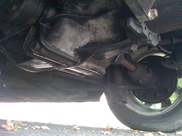

The gearbox is leaking too so its a large bill!
Mike
gearbox pic:
Looks like the seal and or bearing on the nearside , which may be connected with the noises, but as I've said unless the rest of the car is perfect (bit I can see doesnt) and warrents the remainder bringing up to the same level Id leave it.
If you've already got it, a gearbox can be relativly cheap and if you want to play I d change it first, NB they dont balance easily!
Mike
