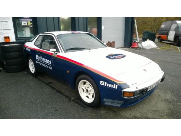

Hi all, pointed this way from my regular perch over on Piston Heads as I have just became the proud owner of 1984 944. She has been purchased as a project for my son to be honest, the last owner has piled a lot of work into the car over the past year and it is now some way to being track ready. To date the following has been done
Roll cage with harness bar.
Drilled and grooved front brakes, greenstuff pads all round
braided brake lines
fuel and brake lines run internally
uprated fuel pump
new fuel pump relay
fly-off handbrake
falken ziex tyres
quickshift induction kit
omp steering wheel
race mirrors
FULL Rothmans replica vinyl wrap
lightweight fixed back bucket seats with porsche and rothmans logos
TRS 6-point harnesses
Polycarb windows with sliders
carbon fibre footwell plates inc alloy footplates for passenger side
new alternator
new battery
custom straight through exhaust with mk2 x-flow rally back box
flip switch and push start ignition system
Waterless coolant
Not a full list by any means and the car was fully stripped and welded prior to starting the work and all appears to be very well done. Will only allow me one pic here though.
