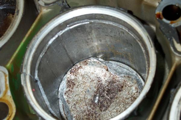

In 2001 I had my 2.5 engine fail at 13000 mls which was a pretty common failure mileage at the time. According to a Boxster forum in the US it was thought the problem affected engines manufactured between October 1997 and January 1998. Porsche replaced the engine FOC even though the car was 8 months out of warranty

This link will explain what was told to me 6 years ago by another PCA tech advisor named Peter Smith who is the shop foreman at my local dealer.
http://www.pca.org/tech/tech_qa_question.asp?id={F3EA752A-E838-43E5-A43D-BB4F445F5A8F}
(Copy the whole of the above line & paste into a browser address bar)
He took several pictures of the failure.
