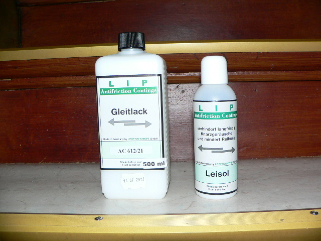

Recently I purchased 2 products from the German company http://antifrictioncoatings.com/english/index.html
one is called Leisol and is in form of lotion. It mainly used for stick-slip free contacts where leather, vinyl or foil covered sides press against themselves.
Another LIP AC612/21 is a ckear coat and used on harder surfaces where Leisol does not work...
I bought both of them.
As you can see from the pictutre they look like OEM products and I do not think you can buy them in the shops...
