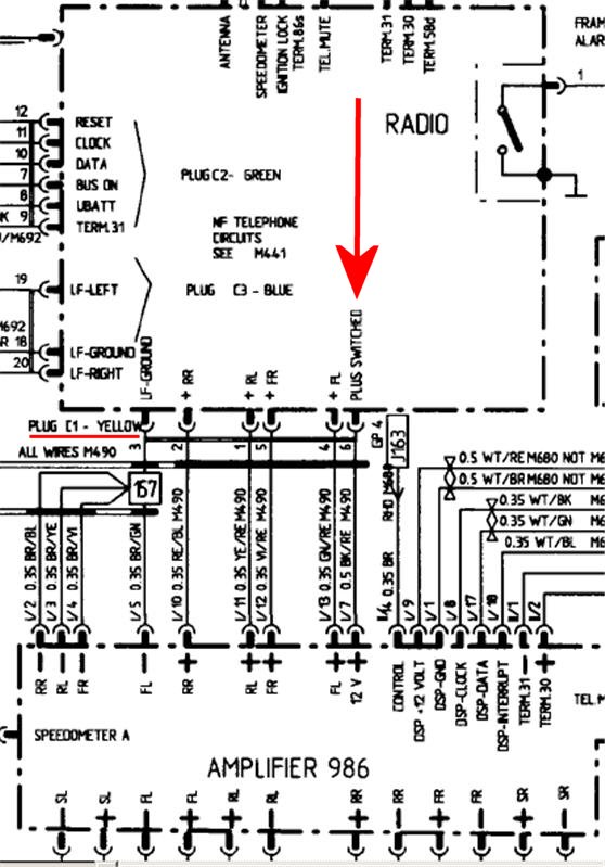

Socket A Pin 5 is the switched supply +ve for the aerial amplifier. Looks like yellow plug C pin 6 should have the 12v+ for the amplifier. If you would like a copy of the wiring diagram email me at richard996 at gmail d0t c0m

There should be a positive feed in there too:

It was indeed pin 6 on connector C1 that had to be connected to pin 5 on connector A.
What confused me was that in the CDR-22 manual the pin 6 on C1 is described as "not assigned" and since pin 6 on the new radio is subwoofer output( combined with the description of pin 5 socket A, for amp on/off) i accepted the "not assigned" description.
