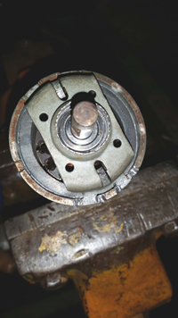

Noisy blower motor bearings
edunit
Quick fix for worn plain bearings is to bore out bearing bracket with a cone-cutter then pressed race into the larger hole. Sealed ball race 22mm OD 8mm ID from RS Components.
