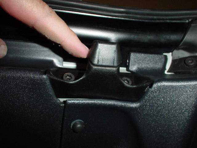

My 986 Boxster S has a hard-top that makes a hell of a racket. It squeaks and creaks like you'd not believe, right above the drivers (ie my) head. Has anyone got any tips about how to resolve this? What about putting vaseline on the the rubber seals?
Any other ways to sort this out?
Where the hardtop fits into the windshield header there are 2 plastic caps. They like to pop off. If one or both are missing you will get noise.
Thanks, that's very useful. When I get home I'll check. It sounds plausible as it only happens on one side - which I'm guessing might be missing. I'm not sure I can tell from the picture exactly where you mean, but I'm sure when I actually look at the thing for real it'll be obvious.
I've had very conflicting advice about using a lubricant. Some say do, some say don't. I might try a silicone lubricant if I can't see this bit missing.
The previous explanation is likely.
This is the lug on the hardtop that fits into the recess on the widscreen surround, covering the lug is a rubber plug that fits over the lug and the whole lot pushes into the recess.

Tool Pants is right, there's a plastic cap missing from the side that is making the noise, so tomorrow I'll be on the phone to my local PC for a tiny piece of plastic... anyone want to hazard a guess at what that'll cost me!
THANK YOU TOOL PANTS!
I've just botched a fix with a piece of rubbery-plastic that was more or less the same shape as the cap and it has completely solved the hugely annoying squeak/creaking. I cannot believe what a massive difference such a simple and small component makes. It's the car I bought again! I took it to refill at the petrol station and didn't hear a squeak out of it... although it's the first time I've had it really empty of fuel and it just set me back £64.42 for a tank of Optimax so I was nearly squeaking myself!
Thank you to everyone who suggested a solution.

FYI: The little plastic cap was only £1 from my local Porsche Centre. Best pound I'll ever spend there!
