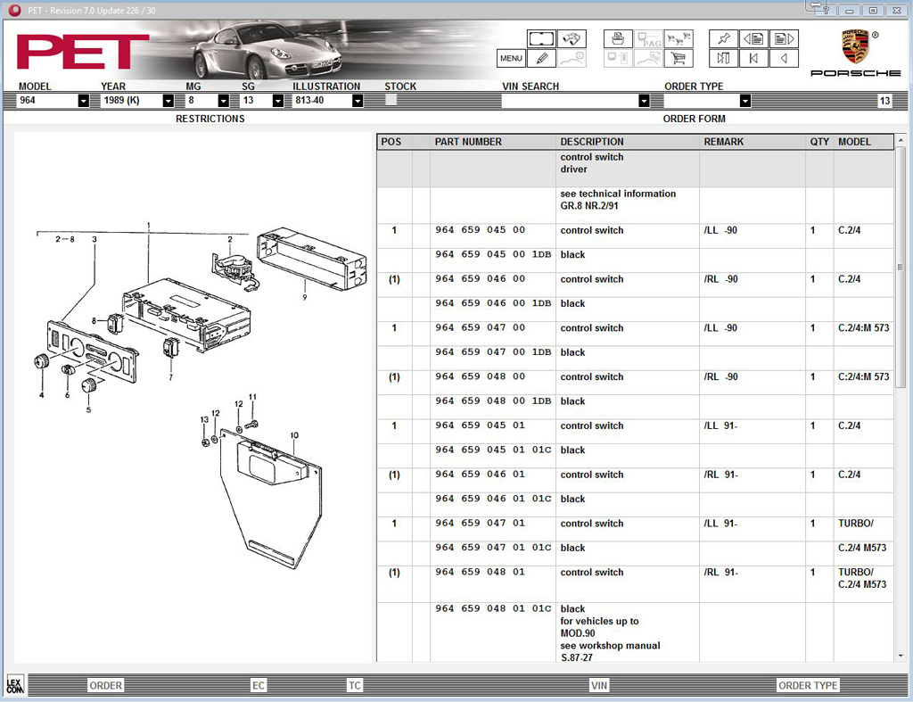

Lee,
See the attached for the various part numbers. Cabs use the same parts as Coupes and Targas (and Speedsters)
Dave
Cheers Dave
Looks like I need the 6th one down 964 659 045 01.
Therefore the one currently on ebay 964 659 045 00 is for an earlier model.
Lee
