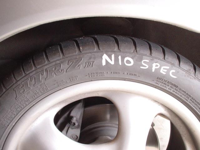

It might be worth reading this first: http://www.tirerack.com/tires/tiretech/techpage.jsp?techid=26 (link also available in the Boxster FAQs on the forum)
N rating, I was told, is a very lengthy and expensive process for both Porsche and the tyre manufacturers (thus not every manufacturer takes part).
A 986 (Boxster pre-2004), for example, cannot take Michelin Pilot Sports 2 (PS2) as they have not been N rated but you can get N rated PS2 for the 996 as it is down to supply and demand. Michelin took the decision that they will be demand for PS2 by 996 owners and went for N rating them but didn't feel it is worth for the 986 (as he kept insisting it is not a trivial process and it is costly), so we still have to use the Pilot Sports original, they can rate them in the future (BTW, 987 and 997 tyres are different size from 986 and 996 for the same rim size). That is why it sort of depends on the cars but then the Mich guys also told me that the new PS2 non-N rated tyres are very similar to the N rated, so I can use the non-N rated PS2 on my car but at my own risk as he said he is fully aware of the warranty/extended warranty issues, possible insurance issues, etc...
If you get a chance, see a non-N rated Pilot Sport and an N-rated Pilot Sport; the thread patterns are very different; though having said that with the PS2 they are very similar, so I assume these manufacturers are probably using the extensive testing with Porsche and then making all their new high performance tyres similar to minimise cost or probably all modern high performance cars are getting similar in terms of tyre requirements(?).

W-rated tyres indicate the max speed rating that the tyre can operate safely under normal road conditions (W = upto 186mph). This is not quite the same as the "N" rating given for Porsche-specific tyres. Your Boxster will not be able to achieve 186mph in standard form [;)] so I would agree with John that the tyre is probably perfectly safe for normal road use. Other than the marketing bumpf, I have never seen any quantitative evidence that empirically shows N-rated tyres to be able to perform at a higher level than the equivalent non-N-rated tyres. FWIW, most trackday tyres are not-N-rated yet these are able to perform at a much higher level than any N-rated tyre available.
With regards to using a non-N-rated tyre and the impact is on your insurance, however, is another issue that has never been properly answered by any underwriter AFAIK.
Getting dedicated type approval for any single manufacturer is a hugely time-consuming (cost-consuming) process for the tyre manufacturers. I suspect that much of this was borne out of the car manufacturers not wanting to engage in any legal matters should a "normal" tyre blowout or be found to be the cause of an accident. (think Ford vs Firestone...). Car manufacturers could partially protect themselves by insisting that a type-approved tyre were used, and if not, the car manufacturer would not be found liable in the instance of a tyre-fault-accident should a non-type-approved tyre have been used. At the same time, the car manufacturer is able to work with the tyre companies on designing a compound/pattern/construction-optimised tyre for their cars.
Its coming back to me....
I remember that we went on a visit to the Bridgestone facility in Ireland a few months back and they explained the difference with N rated tyres to us.
As far as I recall, it has to do with the contruction of the sidewall. As Porsches are traditionally rear engined, or mid engined ( they keep moving that 996/997 engine forward a few mm ) - normal tyres arent designed to take that extra weight on the rears. As a result, the sidewalls are beefed up to be stiffer. I mean its not like you are going to deviate on what tyres to put on a lambo or a ferrari. I guess Porsches are just a little bit less exotic.
I remember someone else gave me an example of a fairly new 964 that came into the OPC in Belfast a few years ago. It just didnt feel right on the road at speed. It turned out that the rears had been replaced with non-N rated tyres and that as the tyres warmed up, there was movement in the sidewalls.
It could just be all a bit of marketing junk - but to be honest, I'll stick with N rated personally. Its not really a big deal to get the tyres approved and specced for the car.
