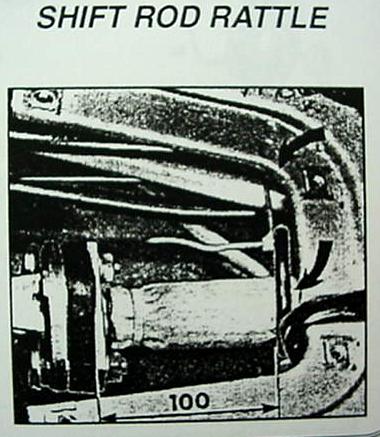

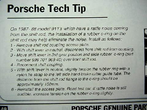

It's probably the shift rod rattling. Irritating but no real issue. Porsche did issue a service bulletin for it but the 'fix' is neither very effective or sophisticated. Basically involves tensioning a large o-ring against the rod. I have a scan of the bulletin somewhere - can post if you are interested.

Here goes....

Interesting point about the shift rattle, Chris_911. I must seek out a collection of 3.2 related Tech Bulletins.
Mine does too. I went so far as to ask a technician to have a look at it and he also said this is completely normal. I'd not heard of the rubber ring fix. Seems like a fairly low cost easy potential improvement. I think I'll have a go to see if it improves things.
The part number is still current on the bulletin. Bought another one recently (thinking of trying two at once to see if I can improve things) - cost £2.58 from my friendly OPC.
