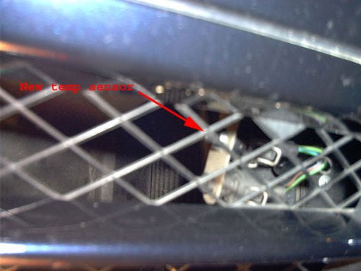

Laura - The OBC should be measuring the outside temperature, and the sensor is located behind the grille of the front PU. Left hand side on a LHD car - not sure if RHD is the same, but it usually is.
We shall have to look under there then! It has got aftermarket aircon fitted by the previous owner which may have disturbed the sensor. Maybe I shall just have to stick my head out of the window as a temperature gauge or just wait until a fast approaching ditch tells us it's below freezing! [:-]

This was taken from the p-car OBC retrofit DIY, but it might help.
